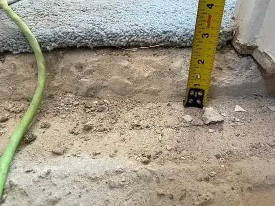

I am renovating our primary bathroom in our 1958 home. I demoed the tile and decided to demo the dry pack used to float the bathroom. After getting the dry pack out it appears my bathroom slab is roughly 2 inches lower than the homes slab (anyone know why?).
I could float the small 35 sq ft bathroom area again with dry pack, but I was curious if anyone could recommend a self leveling product or cement mix that would bring the slab to the same level. Looking at a few of the self leveling products at the big box stores, I am wary about using a self leveling product and potential cracking. I will be laying tile on top. enter image description here

What a great opportunity to do a slightly sunken walk in shower so you don’t need to have any curbs or whatever. Drop a claw foot on top that drains to the floor? Very cool.
Definitely go with a concrete and both major manufacturers have a powder latex modification additive you can use to help with adhesion. Clean and vacuum the existing concrete well.. then etch the concrete with and acid wash. Then apply your new latex modified concrete and you should be good.

I would suggest using concrete and leave enough depth for expected tile work.
Per https://www.cement.org/docs/default-source/fc_concrete_technology/is144-07t-resurfacing-concrete-floors.pdf
The minimum recommended thickness is 1 to 2 in. (25 to 50 mm) for a fully bonded concrete overlay placed on a base slab that is practically free of cracks and in which the concrete is sound, clean, and of good quality. The use of welded wire fabric reinforcement is usually not warranted under these conditions. In general, cracks appearing in the existing base slab can be expected to reflect through bonded overlays.
Since the existing slab is old then I recommend properly cleaning, scuffing, and applying a concrete bonding adhesive/agent to the old slab.

The old homes built from the 40s to and early 60s used concrete as the base for a tile floor. The usual rule was a minimum of 2 inches. This is why the floor is 2 inches lower after you removed the drypack. If you were going to place tile you should have left the drypack there.
Now to correct the issue, pour concrete to about 1 and 3/4 inches. ( Leveling compound is too expensive to use for the whole 2 inches and isn't recommended for that thickness.) Then when it is dry, ( after at least 24 hrs) pour leveling compound to make everything the correct height and and smooth.

I would suggest using the 'self leveling concrete" so you do not have to worry about leveling it.
In you case you have 2 inch total.
First deduct the tile thickness (usually 1/2 inch or more)
Then deduct the mortar thickness, (usually 1/4 inch)
So now you are left with 1&1/4 inch required cement thickness
That can be easily achieved with two coats of self leveling concrete.
Surface preparation is critical, it has to be dust clean and primer coated for adhesion.
