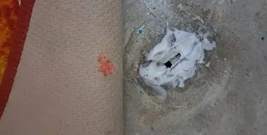

Something has chewed or clawed its way through the basement floor. Our basement is underground obviously. What would be 5 or more feet underneath the ground and chew through a concrete floor? I found it when I pulled back a rug covering the location. Whatever it is had also starting chewing the back of the rug. I panicked and filled the whole with glue, it has now chewed through the glue. I keep a cover over the hole so whatever it can not get inside the basement. Now I worry it might start a hole in a different spot underneath our basement. hole that it has made from underneath

The hole is from something that used to go through the concrete.
Check it out. There is a circular concrete ring around that hole. Here is the original and I outlined ring in yellow.

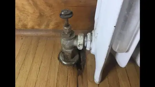

A thing digging up and thru would not lay down a ring in the concrete. I bet this was a hole for a pipe and the ring is from the ferrule that used to be around that pipe. Like this:
ferrule
The new hole in the glue is because unsupported from below, glue fell into the hole.
Maybe when the pipe was removed the hole was filled with something that has decomposed, like a wood dowel. Or it was just left open. Get the glue off and fill the hole with patch cement.
Hmm - you should see how far down the hole goes before you get the patch cement. Maybe there is a secret room under there?
