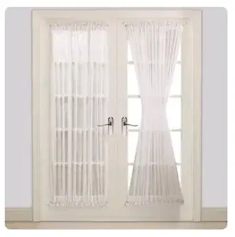

Alternatives are
  1. get it sandblasted, or
  2. attach a stretched curtain
  1. apply a second pane, treated as you wish, to the door or on the glass.
  2. Spray painting one side. You can get translucent paints and "Frosted Glass Spray", but applying them evenly is tricky. (Personally I think it will look very cheap, unless it's used with stencils)
But perhaps you've thought of these already.
Image: https://www.wayfair.ca
