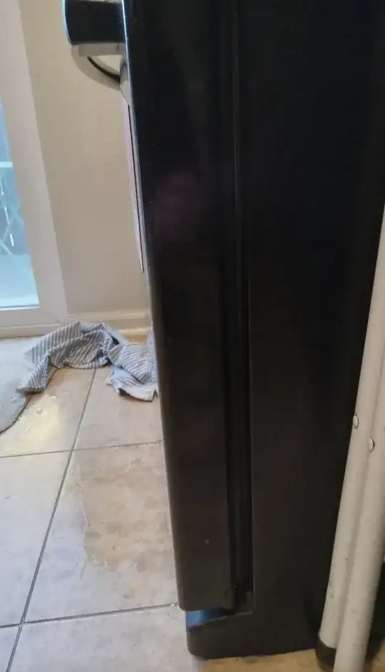

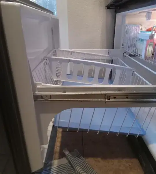

I have a Whirlpool gold fridge/freezer. I had to remove the drawer to defrost. When putting it back in, I noticed that the drawer seems to go in at an angle. Putting it back this way the drawer and door seems to shut snugly. But I would have expected the drawer to stay level. Is intended to go in at an angle?

That basket is meant to sit completely in the lower slotted ridge and flat. Try adjusting it to fit down in there. You might have a basket in backwards, so try switching it around.

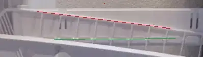

I am betting bar is meant to ride on shelf behind the raised tabs. I colored bar red and shelf green.
pic
That would give the bar support along its entire length which is sensible. Tabs keep bar from falling off the shelf.
Maybe there is a similar setup in the level shelf one up. You can see if that one also has a shelf with little tabs and how that shelf is supported.

If it's not in backwards, any chance the edge of the basket is meant to sit on the upper edge, as shown in the attached picture?
