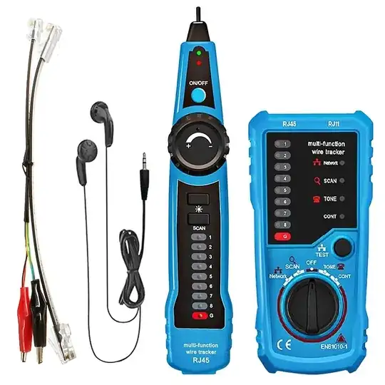

There are devices called "Tone Testers" which plug in to each end of a run and test the integrity of the wires. You should be able to pick one up for about $20. You can get them for RJ11 (telephone) and Ethernet (RJ45) runs. Some will work for both.
Here is one example (https://www.amazon.com/Multifunction-Telephone-Ethernet-Collation-Continuity/dp/B09MRVTDHZ)
There are hundreds of other models for sale from thousands of retailers. This is just an example.

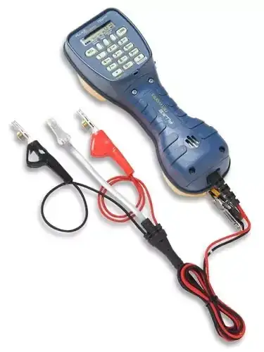

If you're doing this a lot, a common tool is a Butt Phone amongst other things.
This is capable of being a subscriber phone talking to the exchange (aka the Central Office), or the other way, providing voltages to a regular subscriber phone and looking like it is the exchange/CO. They can also listen into an active line without drawing power and affecting the call quality because the have a battery inside.
So you could clip this to one end of your dry pair of copper cables, and have an analogue telephone at the other. Then you and an assistant could both pick up the phone and have a conversation. Some butt phones can cause the remote phone to ring/sound like a regular incoming call.
Downside, quality units will cost $500 US each refurbished or twice that new, so they're out of the reach of handypersons. I've also seen cheap knockoff ones for about $100 US, which is more accessible.
More info: https://en.wikipedia.org/wiki/Lineman%27s_handset
