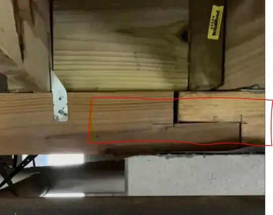

Over the summer (in humid Louisiana), we witnessed a hump emerge (about 0.5" from high point to the low point a few feet away) in our kitchen in our relatively new house. Very annoying. I went under the house, and I noticed that the part of the sill where the two 6"x6" beams meet at the center of the house was slightly upward angled over the pier. It was probably like this at installation, but then the wood probably swelled with the summer humidity.
In any case, this seems to be pushing the end of one joist, and especially the blocking between joists, into the subfloor directly below the hump. I had a structural engineer inspect the house plans and the foundation. He agreed that the center beam was slightly angled and suggested shaving down the elevated part of the sill beams over the pier slightly to relieve some of the upward pressure on the subfloor (providing support for the perpendicular joists in the meantime). He made it sound like a simple job but something tells me it won't be. To me, it seems simpler in theory to replace the blocking with a slightly shorter one that won't push up into the subfloor. Any advice on if this is a good idea, even possible, or how one might go about doing this would be appreciated.
Some pictures here for context: https://i.sstatic.net/qn5lG.jpg.

I totally get the blocking. First blocking is done here to keep the joist from twist and it helps with floor noise and movement. For this particular case the blocking is also there to add pressure to the below join in the framing. Really only one word for this... weird.
I get that they tried to cut that block as tall as possible to keep the board on the lower right from popping. It isn't normal though.
It is popping up on you because it is too big and up is the path to the least resistance. The person that installed it probably never thought it would do this. But the subfloor is way softer than concrete so the board will only push up...
Also this blocking serves no purpose on being installed so tight to the subfloor. Normally blocking is shoved to the subfloor - with nothing under it. Meaning that it is never really "tight" the the subfloor and any movement will probably push it down.
So just take it out and cut a half inch off... I would be much more concerned about this being installed on the bottom of this section than the top. Not saying things will fall apart but the purpose of this was to put pressure on the bottom plates and the join is an easy clue. This should take someone 20 mins to do and doesn't pose any issues.
If you are ultra paranoid or your engineer is - just add a strap or joist brace like below... These are $30 and mins to install and you could do it before changing blocking.
