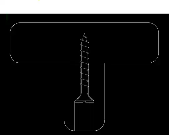

One way you may be able to lower the amount of springiness in the seat slats is to add some hardwood strips to the bottom of each slat. These could be attached with sturdy wood screws similar to as shown below. These can be added as long as possible but just short of the current slat mounting to the cast iron frame.

I cut two 2x4s screwed them together and placed under middle of slats, and screwed to the slats above. It is much stronger now will not break if a heavy person sits on it
I have 3 benches in 2 homes. I strengthened all three the same way
