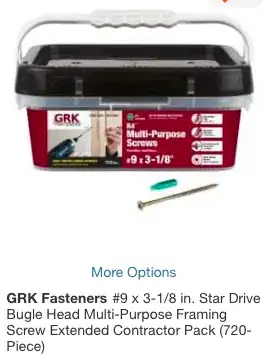

If you want to fasten structural members, you should use framing nails or structural / framing screws for framing elements. Here is an example:
For headers, beams, joists and load bearing walls, use the above.

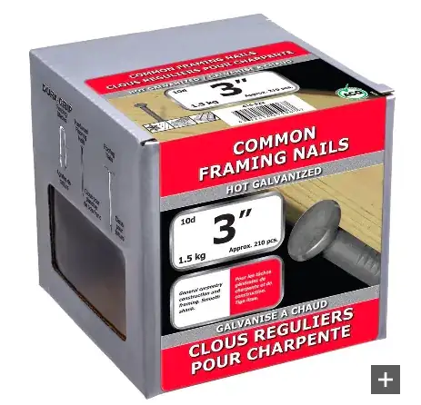

Alternatively use 10d framing nails:
(Building codes specifically mention nail strengths (8d 10d etc..) and nail patterns, and it is up to the manufacturer of screws to rate and test their screws to replace such nails.
