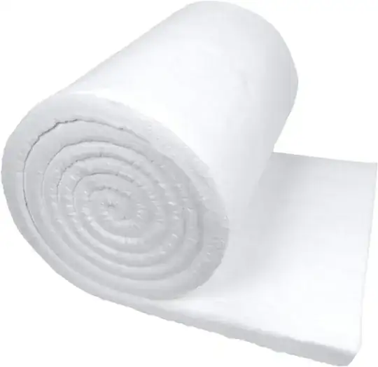

Ceramic (and "non-ceramic" or silica-free - less hazardous to handle) wool is a common refractory material that's flexible/soft. The product sequece generically would be from Asbestos (whoops - not safe) to ceramic (whoops, not safe) to the current era of "non-ceramic" products - though I don't know that the ceramic versions have actually been banned.
"Superwool" ceramic fiber insulation image from Lynn Manufacturing

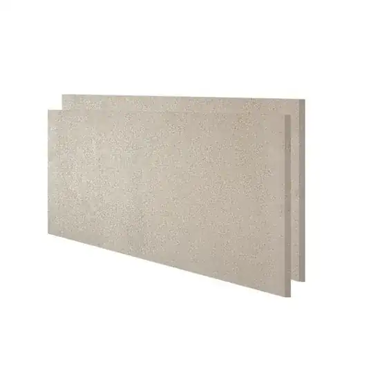

Vermiculite board is a grayish product sold for stove use. You should see a coarse grain in the material, and perhaps reflections from the mica on close examination (vermiculite is steam-expanded mica)
Image of vermiculite board from efireplace store

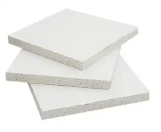

Perlite is a "more styrofoam-like" (or whiter, anyway) volcanic material, but it crushes more than being "spongy." it's typically available as loose-fill or as boards. You should see a coarse grain in the material.
Perlite board image from MG-Materials.com

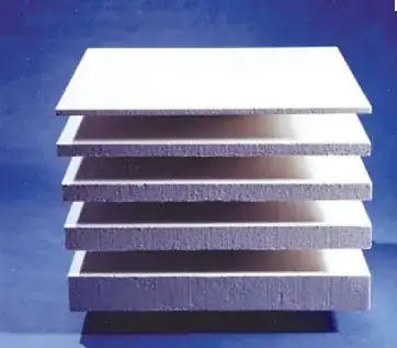

Rigid ceramic-fiber boards are also common. And indeed. while poking around, I find "universal ceramic fiber baffle board, 2300°F rated" as a product. It's probably ceramic fiber board, lacking a picture.
kaowoll boards image from foundryservice.com
