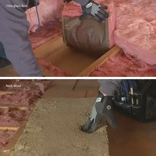

  4. A little distance away from that, reposition an area of the insulation with 2 layers, the top layer perpendicular to the lower as seen in the photo, and once again place a thermometer under this section in the same manner.
