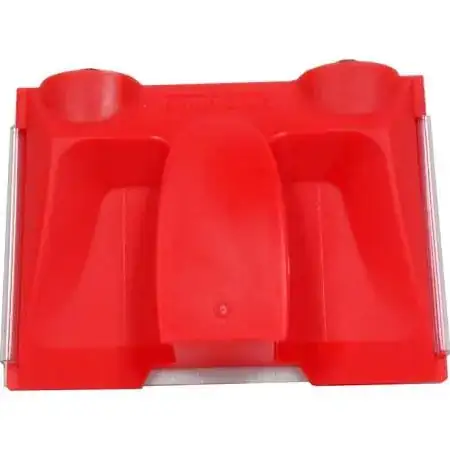

Pro painters will probably scoff but I've been using one of these with the same pad for years and my ceiling lines look good to me. I use it on either the ceiling line or wall line depending on which one gets painted last. Just need to start a couple inches of your line and then bring the rollers down once you know it's not going to drip. Key is to not overload it with paint and make sure the rollers don't get any paint on them. Make sure to go over it with a nap roller or brush soon after and get as close to the edge as possible.
