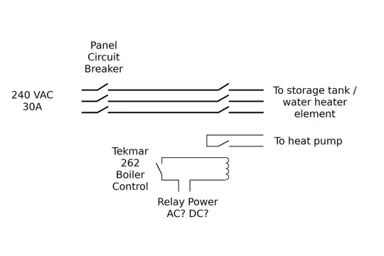

My problem is the tekmar 262 only has two control relays. I'm thinking of connecting some kind of relay to one of the heat pump relays, and wiring that relay to activate the heat pump and the storage tank heating element.
Proposed wiring diagram: Wiring Diagram
Questions:
  1. Is there a better way to do this?
  2. Suggestions for a relay? It seems like a difficult combination, since the heat pump is activated by a low voltage circuit on a PCB in the heat pump, and the heating element is 240VAC 30A.
I understand this is not a perfect solution, as it depends on which heat-pump is down. Ideally, the one which is down would be the one used for this circuit, and it would also be the one which fires second. But for now I would like to get the basic control relay figured out.
