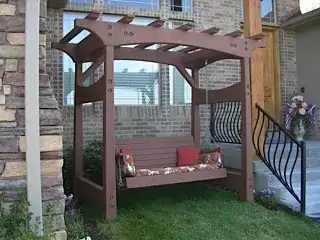

I built this swing about 8 years ago and if I remember correctly I just used Pine, because it fit my budget at the time. If I were to do it again I might have spent more and used redwood or cedar as some others have suggested. When I used to build decks we would always try and use redwood or trex, but both of those are more expensive.
One thing I did do that you should do no matter what kind of wood you use is to seal it. I used a really good protective paint that also contained sealant and some UV protective solution and the swing is still in pretty good shape after 8 years. However, this swing is pretty beefy (I used 6x6 posts and 6x10 beams) so warping wasn't really that much of an issue for me, just a little splintering here and there.
