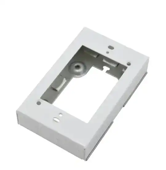

Surface-mount raceways are available: they consist of boxes that mount over existing outlets, where the wire to be put in the raceway is wired into existing electrical work, then running the raceways to a new location, and mounting a surface box for another outlet/light/etc.
raceway surface box
https://www.homedepot.com/p/Legrand-Wiremold-700-Series-Metal-Surface-Raceway-Starter-Electrical-Box-White-BW5/100150790
raceway channel
https://www.homedepot.com/p/Legrand-Wiremold-500-Series-10-ft-Metal-Surface-Raceway-Channel-in-Ivory-V500/100207385
Web-searching "surface mount raceway" may get you to the appropriate equipment needed. Check local code for restrictions.

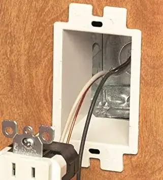

Regarding the outlet behind the shoe rack, if "It would technically be accessible" means that the local authorities would not require you to move it, then leave it where it is. If the shoe rack is a cabinet, the outlet can be brought through the back of the cabinet into the cabinet interior, using a box extender, like this:
box extender for through-cabinet-back outlets
https://www.amazon.com/Arlington-BE1-5-Electrical-Outlet-Extender/dp/B00303FYHS
Check the local authority for requirements for using these things.
