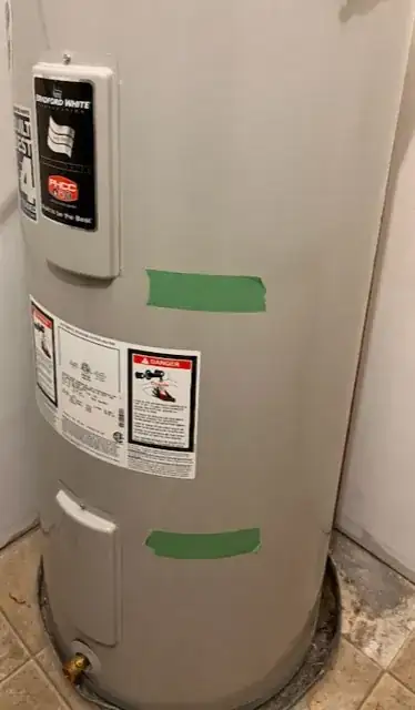

I’m installing seismic straps on an electric water heater (48US gallon), and trying to follow the instructions.
there are two general instructions:
1 - place each of the two straps in bottom and upper third of the tank. this one seems self explanatory… so that the straps hold it in place.
2 - the lower strap must be at least 4" above the water heater’s controls. this one seems awfully specific, and makes more assumptions about heater construction
i’m not sure i can apply these rules to the letter, because they conflict on my particular water heater, but i might be able to do something about it if i understand reasoning behind rule 2.
The tank is probably softer and more fragile around the controls, but why "above" in particular?
Instructions: instructions
And my particular water tank, with the middle of each piece of tape marking each 1/3 mark:
water tank
(the entire bottom 1/3 is covered with an access hatch)
init_js
  • 561
So that the lower strap is not too close to any opening in the tank for the controls.
The instructions are based on testing/experience with the location of sensors and their bosses to avoid breaking or damaging the sensors or tank.
