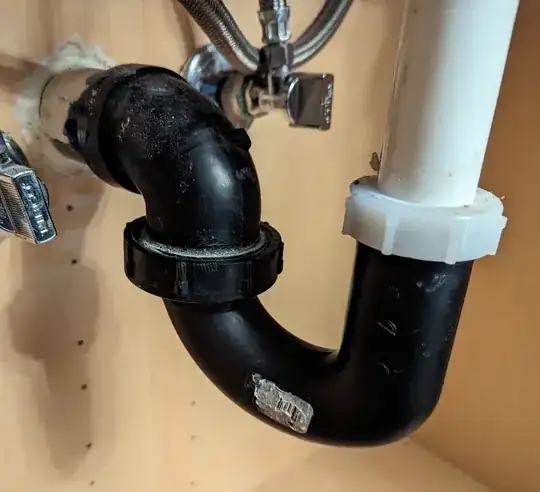

I have this P-trap that I thought was standard. I bought a transparent replacement described as "Fits 1-1/2 in. or 1-1/4 in. ABS" but the fitting (reducing gasket) was too small. So I'm guessing that this is a non-standard size. In my searches I haven't been able to find a larger size that's transparent.
What I'm trying to do
I believe that I might have a siphon problem. In order to narrow down the problem I want to replace that P-trap with a transparent one so that I can see what's happening.
Looking for a solution that would help me get a transparent P-trap fitted onto this non-standard size coupling or some other solution that would help me understand if I have a siphon or other problem.
Problem is that it smells like sewer gas is coming back in. I've already removed and cleaned out this P-trap and replaced it once before but it doesn't make a difference and the P-trap was pretty clean and non-smelly itself.

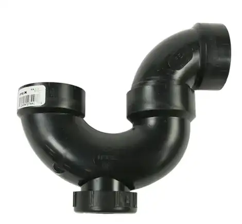

If you don't like opening the unions of the one you have (it can be tricky and stiff at times), a transparent P trap would work of course, but also a "P Trap with Cleanout", a.k.a. a "P Trap with Drain Plug".
Image: Rona / Ipex.
If you have replaced the trap with the capped one, pour the water you drain from the new one in the old P trap to give you a quick idea of whether the trap is open or closed.

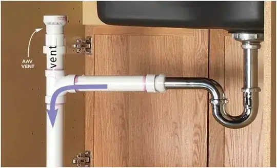

As mentioned, you need to vent it properly, and retrofitting is easier with an Automatic Air Vent (AAV).
Just to show you what it may look like (I am not associated with it).
AAV
Grabbed from Waste Plumbing: Air Admittance Valves and Automatic Air Vents
