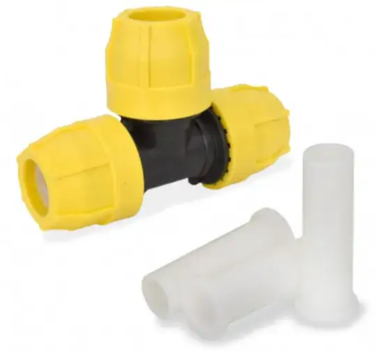

The easiest DIY approach is to use a compression fitting like this one:
IPS compression Tee fitting
My concern is that it requires stiffeners (white in this picture) be added to the ID of each end of the pipe, which will inherently limit flow a bit. My question is: Is it possible to use this type of compression fitting without a stiffener?

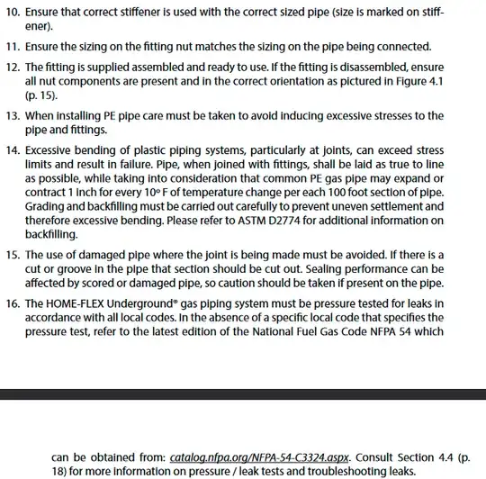

No. One must follow the manufacturer's instructions for installation of fittings; here is a sample section from one:

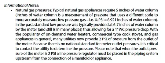

According to the same manufacturer, in recent years many gas companies have upped the gas supply pressure at the meter, so you may have plenty of supply in a 1 inch pipe, but may also have to install an inline line pressure regulator. As they write, you need to contact your gas company to find out the exact situation for your supply.
