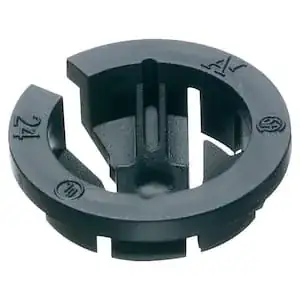

  1. The "push-in", plastic clamp. It pushes into the knockout, then you push the wire through, no screws involved anywhere, like these:
First image from lowes.com, sample link for more detail. Second image from homedepot.com, sample link for more detail

The third type looks to be, by far, the easiest to use. Simply push the plastic ring into the knockout then pull the cable through the hole.
Are there any notable drawbacks to using the simplest method - i.e. the snap in, pull through, leave the screwdriver in the tool belt plastic cable clamp?

The plastic ones almost always fit tightly. They're both hard to remove and hard to change the wire in. I love putting them in but hate having to change anything about them. For that reason I tend to avoid them.

The others fit when they fit, but when they don't fit they're just horrible. In particular the plastic job is sensitive to cable size. I'm no fan of plastic, they don't really fully seal and they're flammable.
