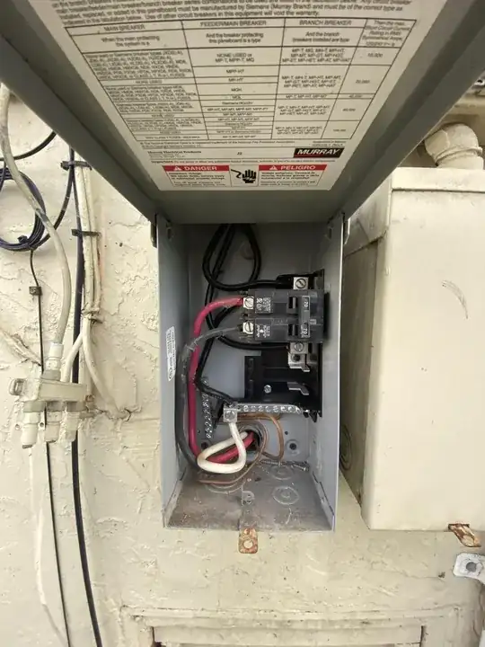

Can I add a 50amp breaker in this available slot and add a 14-50 outlet beneath the box for my EV?

This box appears to be "maxed out" and has other issues.
This box is already serving an existing load, and it appears to be maxed out in serving that load. In fact the wire may not be large enough for that load!
Do the 3 black wires go to the panel? Can you tell us the size of those black wires? (it's written on the wire but is not visible here).
The black-white-red wires, they appear to go to a multi-conductor cable. What does that go to? Can you find anywhere the cable is visible, and give us the text on the cable?
Whatever equipment that 70A breaker powers, we need you to find its data nameplate and shoot a pic.
Lastly this is fed by a breaker in the main panel, right? What size (amps) is the breaker? It'll say it on the handle(s), probably twice.
Do you really, really need 50A for an EV? (no)

Get back to us about data about your wires, panel and loads, and we can figure out just how much power you can get from there, and if an easy upgrade is available.
