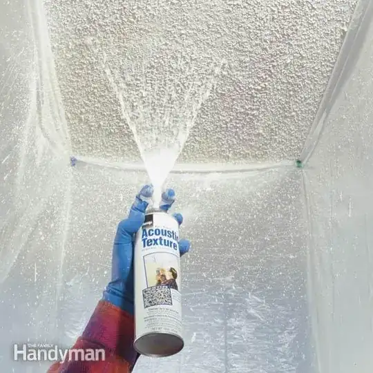

Basically most home improvement stores sell popcorn spray in a can. @Tester101 has provided a link to one such product.
I can tell you from past experience that spraying on popcorn is not like spraying on paint.
  1. Tape off and cover surrounding area. This is a must as the overspray goes everywhere.
  2. Use short controlled bursts. I usually go forward, look at the results and then go back until the desired texture is achieved.
  3. Usually the product expels pretty quickly and somewhat uncontrollably from the can, so you might want to try a test run on a piece of plywood or other large flat surface to get the hang of it before tackling the actual area.
  4. I repaint the entire ceiling with flat ceiling paint after the fix is applied to make the finish uniform.
After that it hard to spot and will not be easily noticable unless you are actually looking for it.

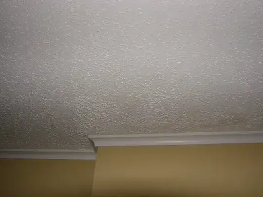

Here's a picture of a patch job. The patch is right on the corner that juts out slightly. It came out pretty well. Nobody ever notices it. The texture is slightly different, but I think if I practiced more before applying I could have matched the texture a little better.
Patch Job
