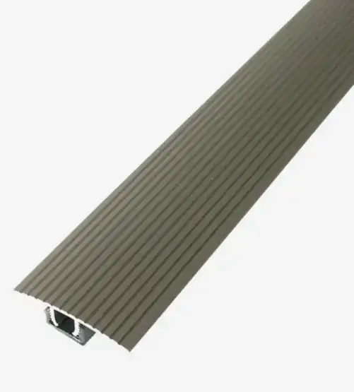

There are many "transition strips" that you can purchase that will give you an acceptable transition. I happen to like this type as shown below. The best working solution I found for installation was to leave about a 1/2 inch to 5/8 inch gap between the two mismatched floor surfaces. I then laid down a bead of good quality construction adhesive and embedded the aluminum strip into the adhesive. I weight down the strip with some heavy blocks to keep it firmly in place until the adhesive hardens.
Note that I discard the plastic channel that comes with the aluminum extrusion. I never found that the stickum strip on the bottom of the plastic channel would ever stay stuck down and the transition strip ends up loose. My method has held up for years.
These can be had with a variety of anodized surface finishes.
