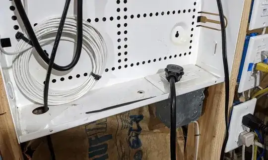

I have some network equipment inside of a Suttle wiring cabinet. There is a punch out for an electrical outlet and it was like this when I moved in to the house. This might be convenient if you just want to plug in, but I have a large UPS so I end up just going out.
Can I take this metal electrical box out of the wall and just remount it to the stud? Seems to be a regular outlet, but I wasn't sure because every other box in my house is plastic. I would rather have it below and them just pass in the necessary power cords from the UPS.
If I need to replace with a plastic box or do anything else (obviously turn off circuit when moving), please let me know.
photo of the electrical outlet in question

Yes, you can move this box. Definitely stick with metal. In fact, one of the many advantages of metal boxes is that they can be moved around and reused easily.
If you simply flip the box around so that the top (receptacles) is now the front and the front is now the right side (it has a hole already that you can use for a mounting screw) then you will find that the faceplate will overlap with the faceplate of the receptacle next to it. So either move it down a few inches or route the incoming NM cable through a side (currently front) knockout instead of the bottom (which will become the back against the stud) so that the receptacles are facing towards the left.
Or do something else - there are a few different ways you can mount this. You can't move it up (both because you don't have extra cable and the wiring cabinet is in the way) but other than that you can put it anywhere as long as:
  • The NM cable is coming through a proper clamp (can't tell if it is right now, if not they are very inexpensive) into a knockout.
  • The box is securely mounted to a stud or some other permanent part of the building.

One alternative that saves passing cords through the door:
Rewire this outlet to be not connected to your household power, but to an inlet, which you plug into your UPS (using a short extension cord.)
Decora-format 5-15P inlet image from Newark.com
Otherwise, yes, you can just remount the same box (I'm in the metal is superior, not so much for grounding but for containing fires, camp.)
Some people prefer metal boxes to cheap plastic, for the better grounding.
No problem to move it to the stud if you follow basic safety, turn off the circuit and check there is no power at the outlet.
You do not want to find you turned off the wrong breaker with your fingers.
