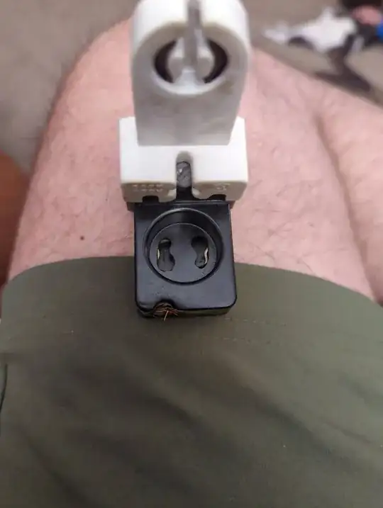

I am upgrading the bulbs in an old fluorescent work light to LED bulbs. I have pulled the ballasts, and remove the starters from the Tombstones pictured below. Is it safe to use these tombstones without the starters in them, or is there a replacement I should look for?

Use a double-ended LED tube. (not single-ended; they're shady and hard to wire, particularly on this fixture). Use a voltmeter to find a terminal on the starter that is wired directly to one of the tombstone terminals. Use that one.

That's a combination I haven't run across before.
Loosen one (perhaps two?) more screw(s) and remove the starter socket entirely. If the arrangement of the light is such that the thing won't stay in place without it, just bypass so your LED wiring is connecting directly to the tombstone, not to the starter socket. But if you can remove the socket and the tombstone will still be held properly in the fixture, ditch the socket, use the tombstone.
Might need to do a bit of continuity testing with a multimeter to sort out the right screws for your new wiring, especially if you are stuck with the socket for mechanical reasons.

Leaving the starter out will leave no connection between there screw terminal in pic #1 and the tombstone.

The only clearly safe configuration with those sockets are SEP (single end power) lamps because you could power the opposite end and leave that end as just a lamp holder.

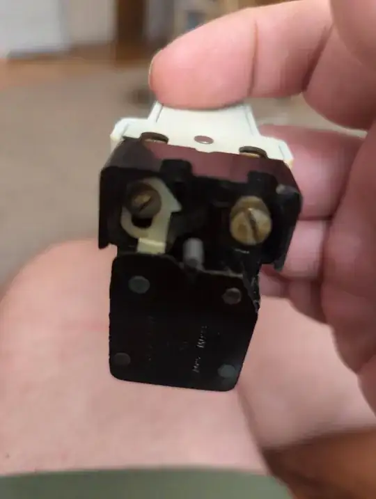

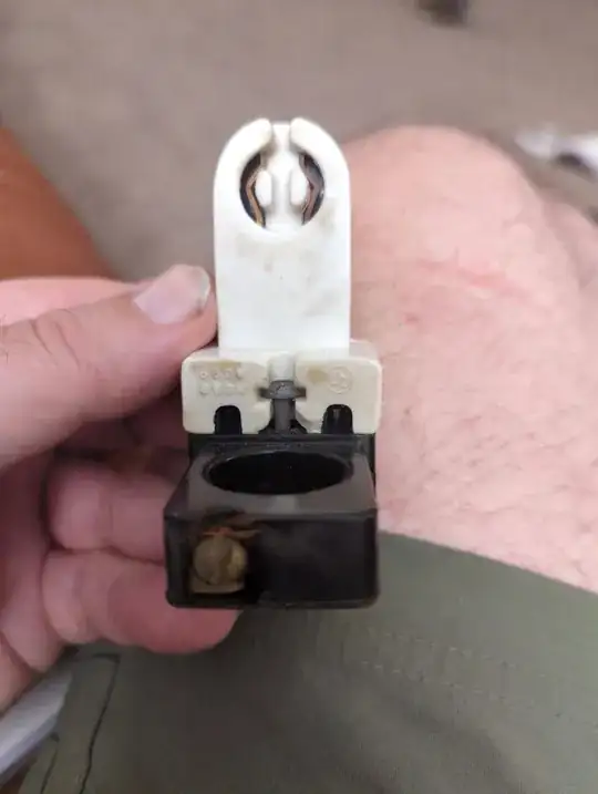

Beyond that if you need double ended feed you could connect separate wires to the two screws in pic #3, and disregard the terminal in pic #1. This would make connection to the lamp socket, but would also leave one terminal of the missing fluorescent starter socket uselessly connected to the circuit. The odds are pretty small that any finger, tool, or part of the fixture would make unplanned contact, but I don't like advising to go beyond UL/ETL approval specifying to use only per instructions.
I think separating the starter socket from the lamp socket has some issues too. The existing terminal screws on the bottom appear long enough to reach through the starter base into the tombstone. If you can remove those screws without damage you would likely need shorter replacement screws with heads big enough to hold wires. Once you remove the screws the tombstone contacts may not stay in place making screws hard to re-install. Be careful when removing the screws that the threads have not been modified to prevent removal. Replacement sockets may be the best route if proper mounting is possible.
