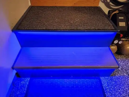

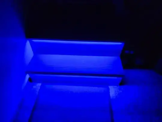

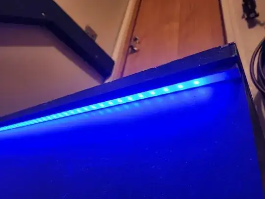

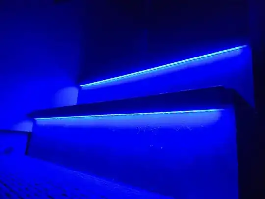

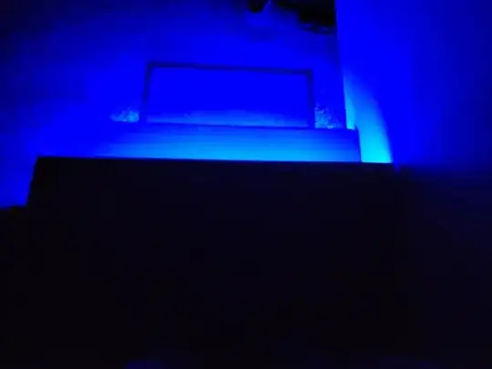

An example of under-the-nose lighting. This was installed shortly after a friend broke her foot in someone else's garage when she missed a single step between bays.
Garage steps: Garage Steps
Bottom view: Bottom View
Bottom view of both steps in the dark: Bottom View Of Both Steps In The Dark
View from doorway: View From Doorway
View from standing in garage: enter image description here
Apologies for the quick and dirty snapshots. And yes, those are blue LED strips.

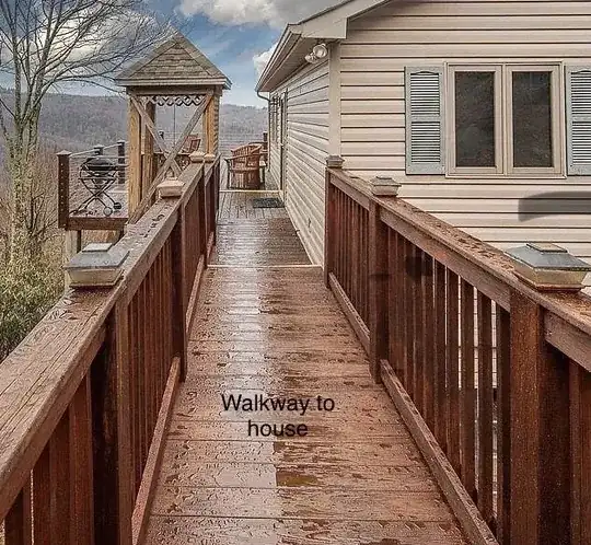

If you simply run it along the edge of the walkway, the step is obvious from the sudden vertical section in the edge of the walkway lighting.
Depending on details we can't see because you haven't posted pictures, you might also divert upwards along whatever railing structure edges the catwalk at that point for more emphasis that "something is different here" and more light in just that area.
