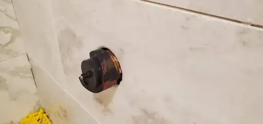

Yes, I used a diamond disc for my angle grinder and just slowly worked around the edges of my marked circle from both sides until I had broken through. Its tedious and dusty but it came out fantastic. enter image description here
