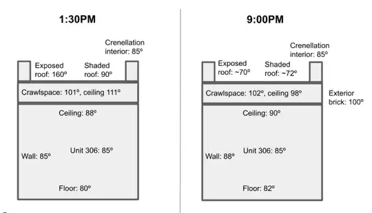

One issue that has remained difficult over time is that intense heat events (>90ºF for us) leave us with a cushion of hot air in the attic due to trapped solar heat, making it difficult to cool the building down, which should be a familiar problem. See diagram for some measurements that I made last summer with an IR thermometer on the roof, in the attic, and in a top-floor unit. There is no building-wide A/C system, only little plug-in units, so in extreme heat the building is very uncomfortable.
diagram of how building gets hot and then cools off over the day Note: all measurements are in ºF. 1:30PM measurement had exterior temp of ~90ºF, 9PM had exterior temp of ~70ºF.

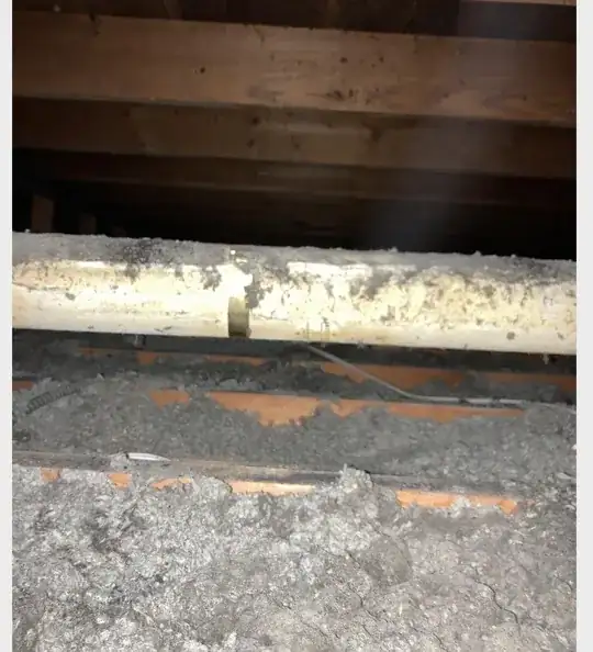

Approximately 20 years ago the roof and attic had significant work done, including blown in insulation the floor of the attic crawlspace (reference picture for a general idea of what it looks like). I don't know the R value offhand for this insulation. The attic is (theoretically) passively ventilated, and others have told me that there is rigid insulation in the roof assembly as well.

Picture of crawlspace with loose insulation

  1. Additional blown cellulose insulation is VERY cheap and based on the pic, it should be done.

I would start with the blown insulation as that is a weekend project. Easy and hard to mess up; just don't block soffit vents. Adding additional ventilation is the next step I would take; if you can move enough air, you can keep the attic quite close to outdoor temperature.

Heat energy in the building is accumulated over the day.
Think about winter. The shortest day of the year is December 21, but that's only deemed the beginning of winter. If there was no thermal mass, then 2 months prior (Oct. 21) would be exactly as cold as 2 months hence (Feb. 21). But it's not. Fall is more temperate because the earth's surface spent all summer heating up, and it 'coasts' on that stored energy for months, making fall temperate. By December that stored energy is depleted, and even though we're getting more solarization every day, it actually gets colder from Dec 21 to. Jan 21.
Well, the same thing happens with the mass of your building. Solar gain 2 hours after sunrise is identical to solar gain 2 hours before sunset. Yet nobody's dying at 10 AM, it's 6 PM that is miserable. Like the earth, the building's thermal mass is causing a time delay to heat effects.
In other words, your house is a battery.
