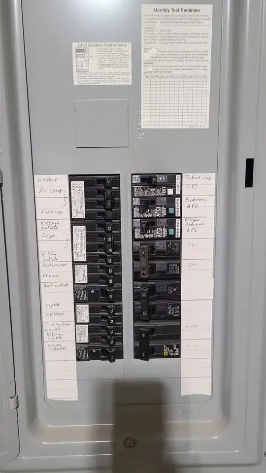

I was reading a few things off google and most say not to plug into a random outlet because backfeeding, but if the main is turned off as step one doesn't that eliminate the possibility of backfeeding? I really don't want to have to wire in a new panel for a transfer switch, couldn't i just install an interlock like this or a similar product?
She is looking at some 3k generators so i was thinking i could install a 30A breaker with an interlock and run some 8 AWG to a 5-30 outlet like a few feet from the panel, and use some 8 AWG to make a 20ft extension cable. I could do a shorter extension cord but it would be a shorter run this way than if i ran the wire for the outlet up and over through the attic to closer to the door so the generator can be outside. I know 10 AWG is the standard for these size runs but i figure going one size bigger would be better that way its a smidge beefier than necessary and i wouldn't have to worry about overheating or anything.
Edit: added pic of main panel I noticed there is no main breaker on here like I thought there was. So the main breaker is outside on a panel right next to the meter and that panel doesn't have a cover it's just one of those wires exposed panels with the big cover on it. So I could still kill the main and put a breaker on the main what I'm now gonna call the main sub panel but I don't see any way to install an interlock since if I put the gen breaker outside it would be on the same leg as the incoming feed which is obviously something I can't do.

No. What your dad did, was replace actual safety with pure skill. ONLY STUDIOUS CARE prevented a dead lineman or family member. If an error had been made, blammo. Average folk can't handle that.
I know you want to think well of your dad, so I suggest taking the viewpoint that this setup was only possible because of your dad's skill. That generation has moved on, and nobody these days possesses the skill or level of care to pull it off. It was never safe and never legal.

An interlock and a proper inlet eliminates several possible problems:

Obviously yes, you do need an interlock for that, otherwise the prongs would be energized when utility power is on. But interlocks are easy anymore. The Siemens ECSBPK01 and 02 are $30. For main-breaker panels they're a little more, but under $100 for any modern panel.

Doing this right isn't even hard
  • √ Want to do it in this panel, not the outdoor panel
  • √ Sane cost
  • √ Safe and legal, so anybody can help your mom safely
  • √ 20-space Siemens panel with 18 spaces used, but 240V breakers that can be made a quadplex to free up 2 spaces.
Easy peasy.
Siemens makes generator interlocks for almost all these panels, in the sub-$100 range. Now all I need to know is if your outdoor main is 200A or 100-125A. We'll be retrofitting a main breaker into this panel if needed, but if it's 100-125A we can get it done with a $30 ECSBPK01 interlock and a couple of branch breakers. A proper inlet of course because you love your mom.

Update:
In order to have a proper interlock, which is safety critical, there needs to be a "main" breaker. Assuming that there is no way to do that at the actual main breaker at the meter, there are two possible options, depending on the specifics of this particular panel. (A picture of the label, possibly on the inside of the door, would help.):
  • Main Breaker
Some panels with a "main breaker" spot like this one can be converted to main breaker panels. An advantage is that is abundantly clear to anyone/everyone without any special labeling.
  • Back-fed Supply Breaker
Move the feed wires from the lugs to a branch breaker. An advantage is that, depending on what interlocks are available, you may be able to put the supply breaker and generator breaker "anywhere" except that obviously they need to be next to each other. Using a main breaker the generator breaker has to be at the top, which might mean more rearranging of other stuff.
The catch is that the largest branch breaker available may turn out to be smaller than the existing (elsewhere) main breaker. If that's the case then you may not be able to properly power everything in this panel, which would be a problem.
In addition, you only have two spare spaces. You will need those for the generator, so to add a back-fed supply breaker you will have to do even more doubling up of breakers - probably replace the spa double 20 and the double 20 below it with a quad 20 in two pairs, making sure that each pair (inner and outer) has common trip.
An alternative is a panel upgrade, as this panel is quite full. But that is obviously a much larger task.
