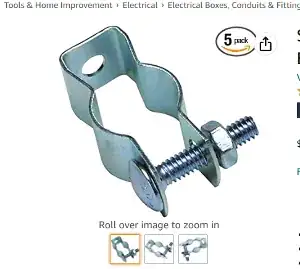

If you don't want to get a conduit bender, you can use conduit hanger clamps like the one shown below from Home Depot. The clamp fastens to the wall and holds the conduit away from the wall.
JACK
  • 89,902
