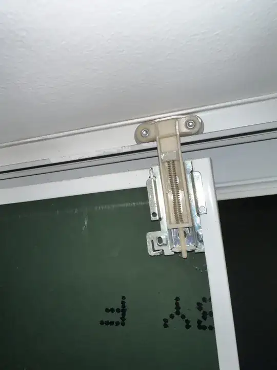

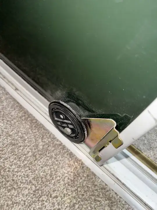

I've just moved into a new house and there is a large sliding wardrobe where the doors are not straight. Having done some research it looks like there is some tweaking at the wheels that can be done to lift the side of each door up and down.
However, I don't seem to find an obvious way to adjust this from the top nor from the bottom. I've attached a couple of photos showing the top and bottom. Does anyone know how I can adjust this?
Bottom wheel
Top wheel

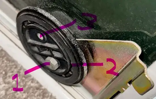

The hex bolt (1) appears to be an eccentric adjuster. Loosen that and swing the inner portion of the wheel, which acts as a ball bearing race (2). It might be near the end of its travel range, so use both wheels' adjustments as needed. The pivot for the assembly is up high (3).
