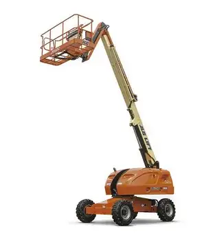

Fifty feet above ground is quite high -- how will the roofer access and perform his work? It might make sense for you and the roofer to share the cost of renting a boom lift for a week or two. You could use it to access the roof with your snow rake and then wait for the sun to do its thing, apply external heat, or cover with ordinary concrete curing blankets outside and heat the attic to finish the job. The roofer could then use the lift to assist in his duties. (photo: jlg.com)
boom lift
