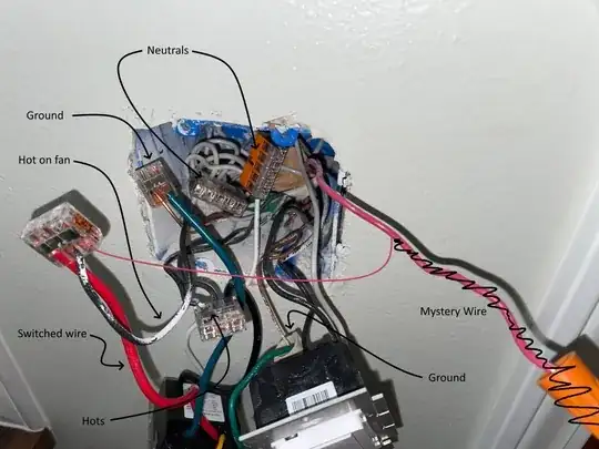

Sadly, even after replacing the timer switch, the fan would still be on whenever the breaker was on! Here's how the wiring looked at that point.
The "before" photo wasn't great, but it was wired exactly like this, except that wire called Mystery Wire was in thn three-hole Wago on the left (where the pink line goes).
Wiring before I changed anything (The switch on the right is irrelavent - it's the light switch that got in my way. The timer switch is the one on the right): enter image description here

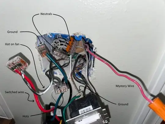

Via some (careful) testing with my multimeter, I determined that the wire called Mystery Wire was actually hot - and given that it was in a Wago with the switched wire from time timer switch and the fan hot, the fan would always be on as it had the Mystery Wire (which was hot) regardless of if the Switched wire was hot or not. So... I capped the Mystery Wire off, and now everything works as expected (the fan shuts off when the switch is off).
After picture: enter image description here

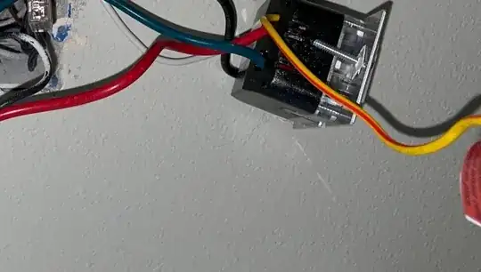

The timer switch had a handful of wires pre-attached. See photo (the wire that is blue-ish in the photo is really green - sorry about the somewhat-poor photo)
When replacing it, I kept the same configuration. Here's what it is:
Switch Wire Color What it goes to
Green Ground
White Neutral
Black Hot
Red Fan in (hot on the fan)
Red/Yellow Nothing (capped off*)
*Directions say it is for a three-way switch, and I'm not using one here)

The logical answer is the "mystery wire" is from a 3way switch somewhere in the room, ( or possibly in an adjacent room) that someone switched on. The fan timer probably replaced the other 3way on that circuit.
RMDman
  • 52,615
  • 113
You could have a main floor switch that controls the fan upstairs for ventilation. So basically that red wire is switched power from that switch downstairs, and it overrides the switch in the bathroom. See if you have a switch that you don't know about. Usually near the thermostat on the main level.
