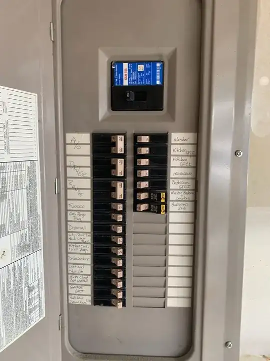

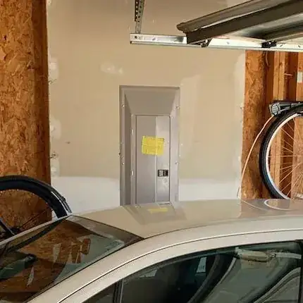

I would like to install an EVSE. The main panel is in the garage and I should have no problems running conduit a few feet to the location where I plan on mounting the charger. I will make sure I get the correct breaker, wire size, and receptacle according to the specifications on the charger I end up getting. But before I buy a changer, I am curious to know how much additional power I can get from this panel. Obviously I can't just add up the capacity of all the breakers because they are already much greater than the main breaker. I suppose I should do a load-calc, but I have no idea how this is done. Do I need to look at the data plates on the back of all my appliances? This seems like it could be a lot of work.
If I just eyeball the loads, I guess that this service and panel should be able to supply another 30 amps without any problem.
I suppose that if I run the oven, all the burners on the range, the microwave, the AC, the dryer, a few hairdryers, and charge my car at the same time I might pop the main breaker, but this seems not likely for our family.
Garage
Panel

A NEC Article 220 Load Calculation is the right way, and not that hard.
That's just naysaying talk. No, it's not that hard. You only need to do that for fastened-in-place loads and only fairly large ones (e.g. not lights or bathroom fan, not range hood, and not refrigerator - those are too trivial to bother measuring.) So we're down to water heater, range, built-in A/C, furnace, dryer and a few other luxury items.

There are online load calculators, such as this one.
If your power company provides downloadable usage information, that can be a useful guide as well. Typically those provide either hourly or 15-minute information for up to a year. 15-minute data is best, as that is the standard for metering. They may provide kW (peak or average demand) or kWh (actual usage). What you are looking for is peak demand in Amps:

Ideal is to do both a load calculation and an analysis of the past year's usage and use whichever number is higher.
Once you figure that out, you will know how much headroom you have for EV charging. EV charging is a continuous load, so it is derated. For example, if you use a 20A circuit then you will actually only charge at 16A, 40A at 32A, 50A at 40A, etc. The breaker has to be sized based on the capacity of the wire, even though you will typically set the EVSE for 80% of that capacity.
You have a 150A main breaker. That is a little unusual - more common these days is 200A, and the panel may well be rated for 200A, so I suspect that is based on the utility service and/or the feed wire from the meter to the panel - i.e., you can't upgrade that without utility consent and making sure everything is just right.
The good news is that you have at least some gas appliances (presumably water heater, at least part of the kitchen equipment, furnace), small A/C (20A) and not a lot of extras, so my guess is you could install 30A or 40A without much of an issue.
But keep in mind that most people don't need more than 20A or 30A @ 240V to keep up with daily EV usage by charging through the night.
Also, do not install a receptacle. Install a hard-wired EVSE, whether Tesla or another brand. There is nothing gained by using a receptacle if you are going to leave the EVSE plugged in 24/7. If you actually need a high-powered receptacle for occasional other use (RV, welding, etc.) then you can install that on a separate circuit as you have plenty of space left in your panel. A receptacle adds another point of failure and in the latest NEC code GFCI is required for all garage receptacles including high-power 240V circuits which were previously exempt. Since EVSE includes GFCI circuitry, a hard-wired EVSE circuit is exempt from this rule.
Normally aluminum wire is worth considering for large loads. However, most (if not all) residential EVSE are not rated for aluminum wire, so use copper. Since you only have a short run that is not a big cost.

You are in luck given that your panel is right next to the place where you would put the EVSE. So the surcharge in bumping up the size of the wires to the EVSE is minimal.
So you can put in the max wire size and breaker but then limit the current at the EVSE if it would overburden your main breaker.
