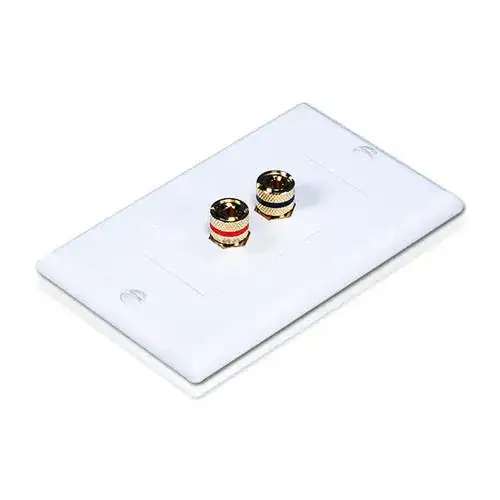

You might choose to fit some binder posts in a plate, or a pair of RCA plugs in the ceiling for convenience and neatness, though its another joint in your wire and generally unneeded. Smaller plates may be more suitable too.

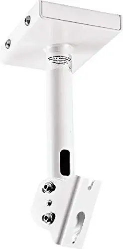

You can also arrange your rear speakers such that they sit in front of the holes, or if you choose to use mounting brackets then they can straddle the hole and hide the wire as it comes down any internal channel. Although these brackets need to mount into something structural in the ceiling, not just into the drywall/cladding.

Simplest standard approach would be to locate a "low voltage ring" (looks like a junction box, size-wise, but has no box) directly above your speaker locations so it's mostly hidden, and then you can have a nice finished plate for the pass-through (or terminals, if you want.)
Drilling a hole and caulking once it's done is also perfectly acceptable.
There are wall plates available with RCA jacks, 1/4" phono jacks, etc. (just listed as examples). As mentioned by @crip659, they do not require junction boxes.
Some have plaster ears, the tabs on corner shown in this AC outlet to allow mounting the outlet itself flush with the wall (or ceiling) surface, to be covered by a plate. Others may have metal tabs or cross-bars that fit through a cutout in plasterboard, and "sandwich" the plasterboard between the tabs on the inside and the outlet, outside.
