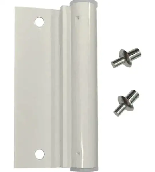

What's the easiest way to remove the rivets from my lower hinge without damaging the screen door jamb.
A video of the lower hinge with rivets:
https://www.youtube.com/watch?v=RqJT5Y5BNms&t=206s

You need to experiment. If they're tight and don't spin you can drill them out. If they're soft enough you can cut the heads off with a wood chisel. If they're loose enough you can get a nail lever behind the head and carefully see if the front or back of the rivet will break before you damage the door frame. If none of that works, carefully using a small grinding wheel on a Dremel, while risky, might work.

Drilling them out is the easiest and less damaging.
Use a drill bit a bit smaller or same size as the hole/rivet shank diameter.
