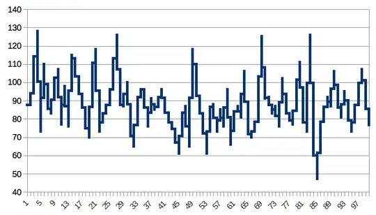

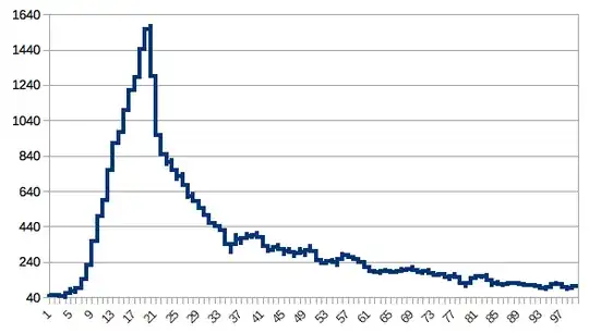

Well, on the one hand, radioactive decay is a statistical process, so the closer you look, the more variation you have. Longer averaging times smooth out that effect. Here's my last 100 hours with the fan working (in Bq/m3) at one-hour resolution: (100 Bq/m3 is the same as 2.7 pCi/l)
1 hour radon

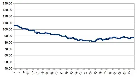

Same data with 24hour averaging applied (including the 24 before this set affecting the first 24 of this set) - there is an effect of weather on the inflow rates.
24 hour average radon
The model I have claims to be:
Individually calibrated by equipments (sic) which are already calibrated to traceable international standards.
It claims to make 30 tests per hour, reports them locally at 10 minute intervals, and logs the average of those once hourly. The hourly result (and 10-minute result) does bounce around.
