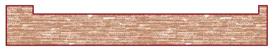

I am building interior wooden cills and from a 3m x 250mm board/plank (25mm thick) I need to remove a rectangular section about 50mm thick along most of its length, giving something like: enter image description here
I have a circular saw and jigsaw but no plunge saw or table saw or router, as well as regular hand saws and a multitool (ugly but useful). I am happy to acquire more hand-tools but ideally not expensive power tools for one job.
What is the name of what I'm trying to do, and what would be a good technique? I have 3 of these to make.

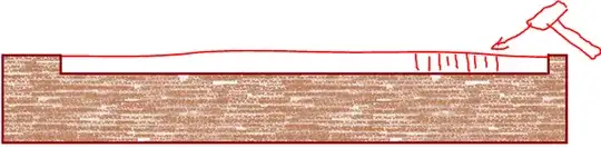

To make that start you can make a series of cuts along the side and then snap off the little tenons that remain with a hammer. Then it's a matter of cleaning up the remaining surface and extending the cut as above once the circular saw fits in.

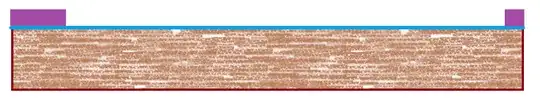

Something that hasn't really been mentioned, but almost hit on in a comment by jay613, is to cut off that whole strip of wood (meaning to cut your board to the narrowest width you need along the blue line below), then glue the tabs back on (purple).
Board cuts example
It's not as pretty or as quick as a notch, but this could work. You'd just cut the tabs out of the material you cut off the board.
Or you could use a narrower board to start with and cut your tabs from some other board.
You'd have to wait for the glue to dry, making sure to wipe any that squeezes out, then sand it smooth again. So, definitely not as quick as a notch.
Wood glue is stronger than wood (at least the name brand stuff is), so you shouldn't have to worry about the tabs breaking off.

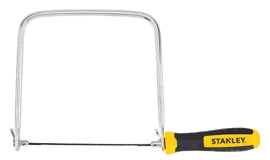

One hand tool you might not have heard of is the jigsaw's predecessor: the coping saw. It's a bit like a C-clamp and a hacksaw had a baby.
Coping saw
The two features of the coping saw are
  1. The blade is pretty thin, so it's versatile
  2. The handle rotates a bit, which twists the blade so you can guide it easily
This is a more precise tool for those close cuts. It's also cheap and easy to find.
