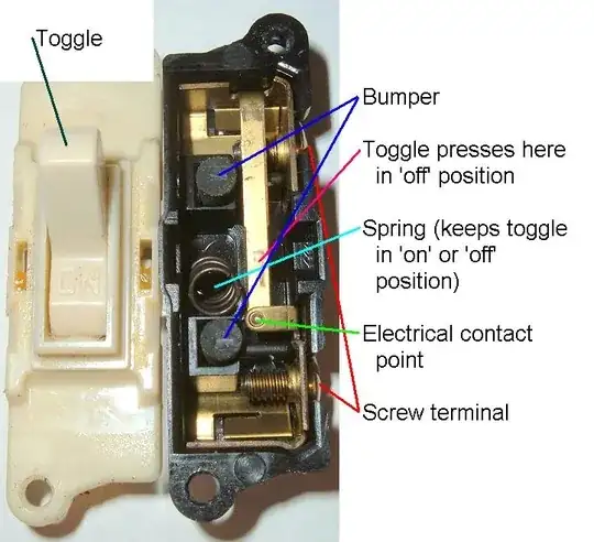

No way to know for sure what the problem is, but something has obviously broken. My guess would be the internal spring; it probably got bound up inside, making it hard to flip the switch, then broke, making it easy. If the spring is in pieces, those pieces may migrate and cause a short somewhere. Or it could be the toggle's pivot that broke. Who knows?
Switches are cheap enough—just replace it.
