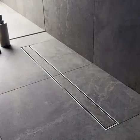

If you don't like this "X" look then a solution is to use a line drain, which avoids the inverted pyramid shape: the floor can have only one slope plane. Pic source. However now you have another problem, which is this huge expensive drain which accumulates a lot more crud than a small one in the center.

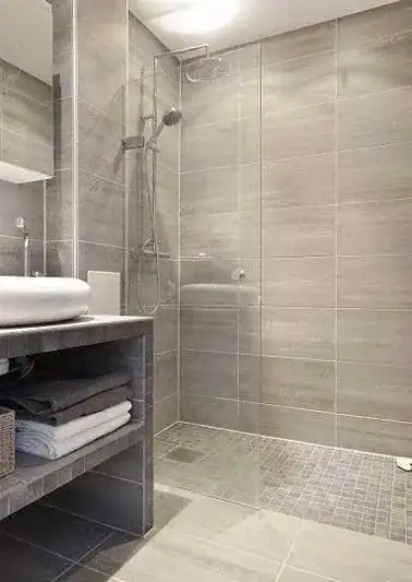

One advantage of small tiles is they can easily follow the shape of the floor so it is possible to build an inverted pyramid sloped tub, with the drain at the proper spot (ie, the bottom) and tile it (pic source):
That's the main technical (non-aesthetic) reason for using small tiles.
