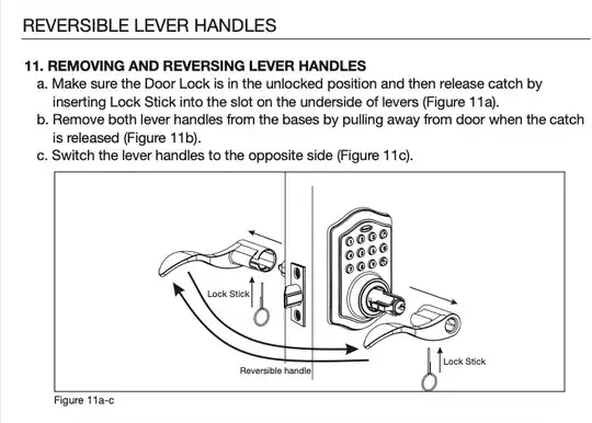

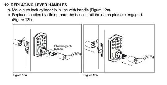

Unfortunately your installer did not install it correctly.
You can reverse the handles following this simple instructions.
reverse
fig 12
from: Honeywell Models 8734001, 8734101, 8734301, 8734401

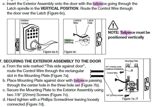

The handles are installed correctly. The issue is that your "tailpiece" was not installed correctly.
Check to verify that your lock's tailpiece was installed vertically.
If installed Horizontally then your lock will not function correctly.
https://content.interlinebrands.com/product/document/10164/3581622_Installation.pdf
