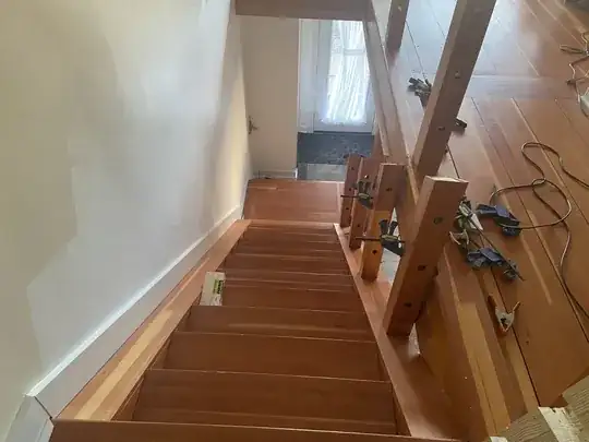

I have a rather complicated situation with the LEDs I'm trying to install.

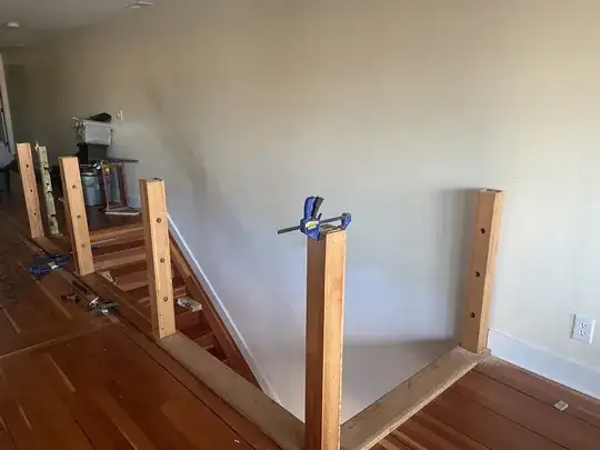

There will be a railing on top of the posts and I’m want to attach the LEDs to the bottom of the railing. Here’s were it gets a little complicated. I’m hoping to do motion sensors on both the top and bottom of the stairs. Plus, the only outlet available for this is the one next to the post in the picture so the power source has to be there.
I have done some small LED projects in the past, but nothing quite like this. I’ve tried to do some research but nothing I’ve found so far will work for my situation.
Thanks in advance for any help or advice. I am just trying to figure out if this is possible and if it’s not what your would recommend.
