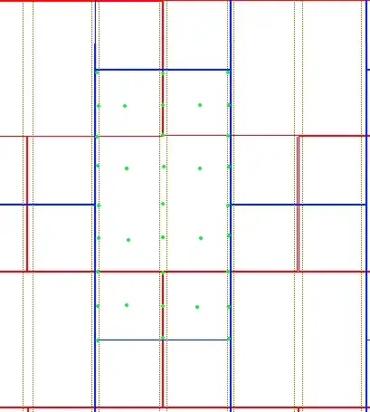

You are going to need a lot of adhesive between the 2 layers.This is because of the sag between the joists with the original sub floor. I just removed the sub floor in my kitchen, dining and living areas. 1/2" ply with 16" OC joists. There was a lot of sag between the joists and the floor had 3/4" thick white oak on it too and there was still a huge amount of sag. Lots of construction adhesive and no less than 35 screws in each sheet.
Here is an image of how it should be done.
The red lines is the original sub floor and the dotted lines are the joists, blue lines are the new sub floor and the green dots are the screwing pattern. The new sub floor should be laid down rotated 90° and overlapping the old sub floor like what you see in the picture. Now I know you have the piping and aluminum plates so you are going to have to use a 3/4" screw. I suggest using a sheet rock bit to drive the screws in this way you know you will not be going in too deep. You need to pull the areas that are between the joists together . I would also use a construction adhesive liberally between the sheets. Probably going to be close to one large tube per sheet the large tube (28oz) is good for about 85 or so linear feet. You are going to want to go up and down the length of the sheet 8ish times that's 64 linear feet right there.
