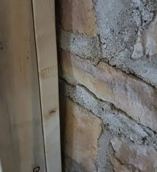

I'm working on converting a stone barn into a house. Some of the stone walls I'm leaving exposes, some I'm covering to insulate better.
In some locations, I have a 90° interior corner where drywall will meet uneven stonework.
How does someone normally finish such a corner? (the drywall will attach to the wood studs pictured)

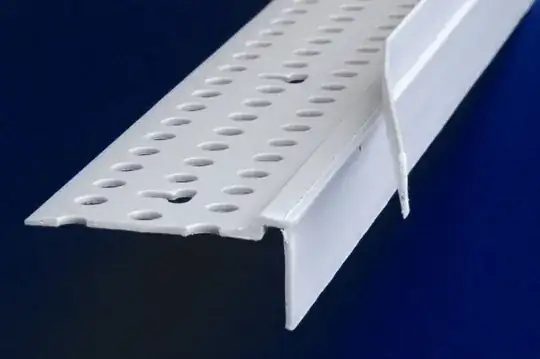

You can use a tear-away bead to provide a clean finish to the drywall edge. It’s quick to install and also protects the stone/brick from getting mud and paint on it. Afterward, you can decide if you like the finished look; if not, you can scribe a piece of trim or caulk the gap.
Here's a YouTube video on installing it: Vancouver Carpenter
