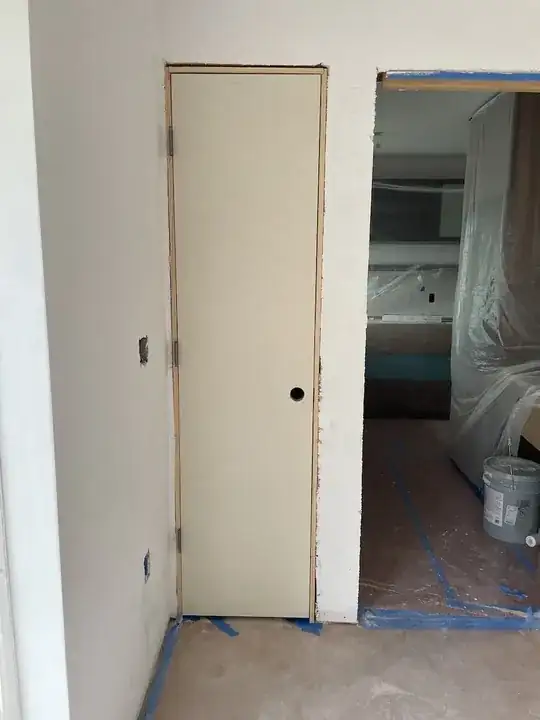

Anyway, the door is installed but the contractor is saying that we need to have door trim around it. Obviously having trim around it is going to make it pretty obvious that there is a door there, kind of spoiling the effect. He said we could wallpaper over the trim but that seems a bit odd too. Is there no way to seal up the gaps around the door with putty or joint compound or something to make it flush enough with the wall so that we can wallpaper over it?
Here is what the door currently looks like. Note that it was not supposed to have a hole for a knob so we are going to have that filled in.

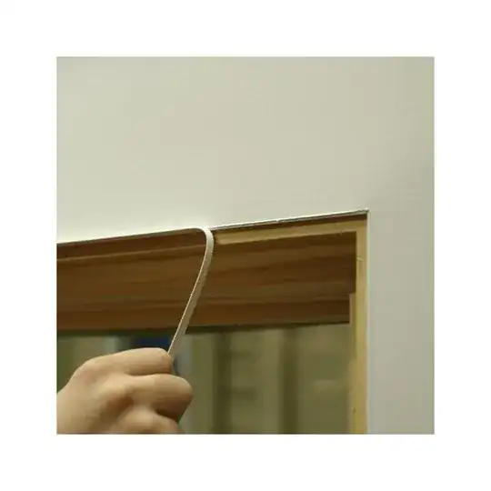

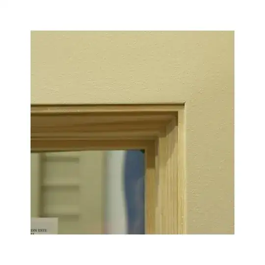

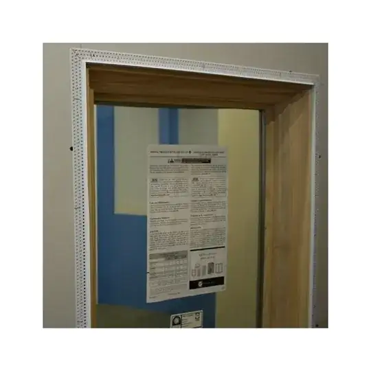

You can use a flat tear-away bead to provide a clean finish to the drywall edge around the door.
Before mud: enter image description here
After mud: enter image description here
Finished: enter image description here
