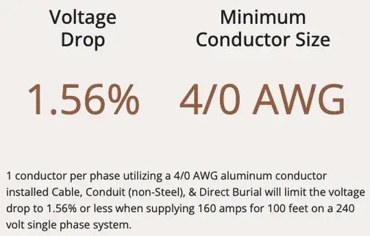

OK so you're the second guy today to do what I call a "bamp" or "randomly enlarging wire size as an emotional decision rather than actually do the calculation". These end badly - either in excessive voltage drop, or wasted money. In this case you flubbed twice: that wire is too big for 2" conduit, and the bump is gross overkill. Really, on 240V there's no point even doing the calculation til at least 170'. 4/0 (your absolute minimum assuming you never upgrade the service above 200A) is perfectly adequate. Even the wire salesman doesn't recommend a bump below 3% and 4/0 comes in at 1.56%. You might go 250 kcmil for in case you upgrade to a 400A service in the future. (the special rule allowing 4/0 no longer applies).
