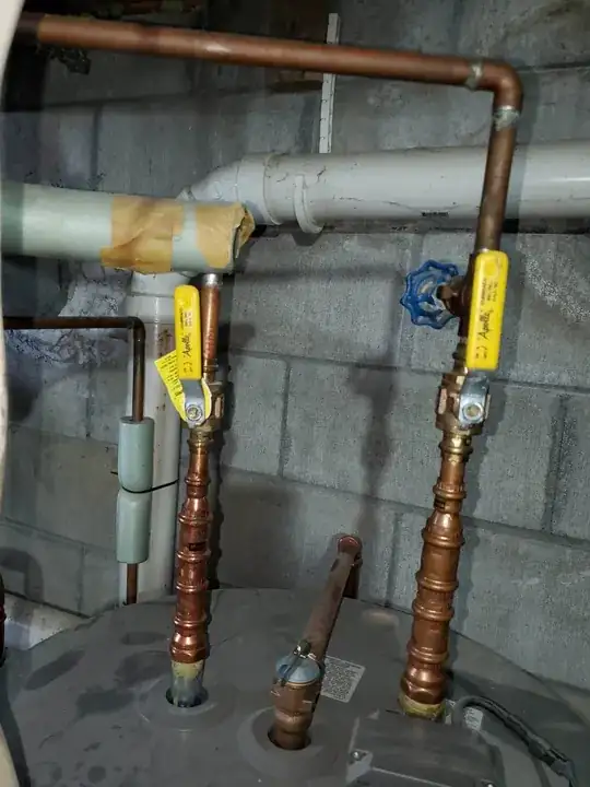

There really aren't any "Feeder Valves" in between my hot water tank and my leaky valve, except for the valve that is coming out of the hot water tank itself:
The left pipe (that's wrapped in insulation) is hot water coming out of the tank. That pipe splits several times, and one of the "branches" goes right to the leaky valve, some 30 ft later.
So my question: given everything I've said, am I going to do any damage or cause myself any headaches by just treating that valve in the photo as my Feeder Valve, and turning it off before I cut out the leaky valve?
I guess my concern is that with that valve turned off, once I cut my leaky valve out, the water from the other pipes branching off are going to try and drain through where I make my cut. I guess I'm also worried about turning that valve off so close to the tank and possibly damaging my tank or turning it into a pressure cooker somehow.

You aren't going to hurt the water heater by turning off the hot water outlet, that's what it's for. That pipe in the middle is your pressure relief if anything did happen. As far as water draining from your cut, open any hot water fixtures on the top floors to let air in and the system will drain niceley.
