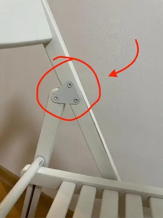

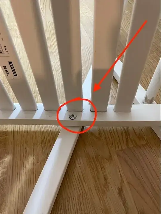

Over the years, I've bought many IKEA Terje foldable chairs. It's a popular model.
However, they quickly get "wobbly". I think the problem is with the joints (although I'm not sure). Any ideas on how to tighten them... I actually think it's not possible to tighten them...
Video of wobbliness.

You'd need to re-squeeze the rivets, which is likely impractical, or just temporary respite.
An alternative may be to replace the rivets with nuts & bolts - though if you're stripping the joints that far, it would probably be better to also re-line the holes, as they will be expanding due to the off-axis movement occasioned by the loosening of the original rivets.
Maybe something like small dome or countersunk barrel nuts could do the job - & be less prone to snagging on things.

Those fasteners are rivets. You can tighten them up by placing the smooth end on an anvil or other very hard surface and hit the other end with a large nail set and hammer. The problem with this is it's not a long term fix since the wood has been ground down a bit and you can only compress the rivet so much.
A more durable fix would be to grind the rivets off with a rotary tool and get some nuts, bolts and washers and re assembly the chairs. You can repair any ground down wood with expoy or wood filler.
