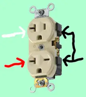

Anyway, the answer to your question is there is no limit to the number of receptacles on a 20A circuit, unless you're in a commercial space, then the answer is twelve. For purposes of this count, this picture contains 1 receptacle
and this picture contains 4. (all allowed on 20A circuits).
