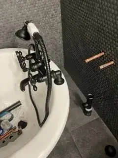

I have a clawfoot tub with a 1-1/2" brass drain to install to a 2" ABS floor drain. There's already a 2" to 1-1/2" ABS reducer cemented to the drain by my previous plumber. My original plan was connect a 1-1/2" trap adapter to the brass drain and then come up with something to cover it later. When testing the parts together, I found out that the reducer+trap adapter combo places the horizontal brass drain nearly an inch up from where I need it to connect (for the bottom of the tub).
I was considering cutting the ABS from the bottom of the reducer and placing a flexible coupling, but I'd still need a trap adapter or something similar. I haven't had luck finding shortened couplings or reducers. Is there some other solution to this sort of problem I could use?

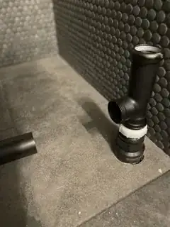

Wider view of the tub and brass drain placed onto the trap adapter/reducer (not cemented)
close angle of the brass drain to abs

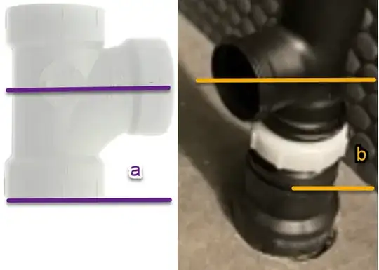

  1. Measure distance (b) below. It's hard to see from the picture. If (b) is at least 3.5 inches go shopping for a 1.5" sanitary tee where measurement (a) is an inch less than that. They are typically a bit under 2.5 inches. Ta da, there's your inch back. Now the ugly part.
  2. Saw off the trap adapter, and use a PVC reamer to remove what's left of it inside the reducer. Then glue in the 1.5" sanitary tee with exactly enough pipe to line up with the drain arm. That might be zero pipe showing between the reducer and the tee.
  3. Then you build a frankendrain. Separately connect the drain arm and the overflow pipe to your new tee using bits of PVC pipe and suitable fittings. Then, I guess, paint the whole thing black?
