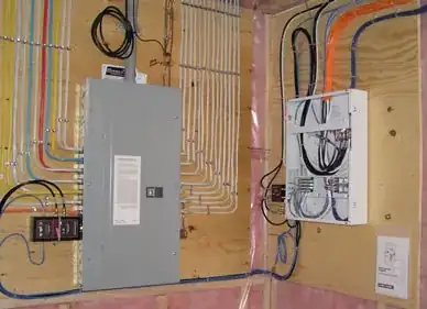

I'm not sure what code requires for routing, but it's probably best to drop the wire down in the neighboring cavity and cross through the stud at least 6-12" below the panel before coming back up to keep things nice and tidy. Or for a surface-mounted panel just route the cable neatly and anchor with cable staples:
