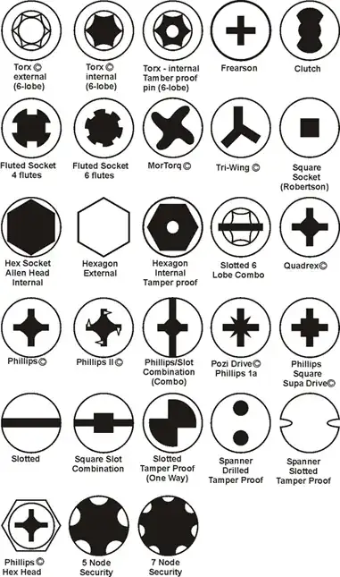

I thought it would be useful to include an image/link to some drive types found on screws and bolts (obtained from bontool):
http://www.bontool.com/knowledge_center/Support_files/KC_%20Misc/Screw_Drive_Styles.jpg
